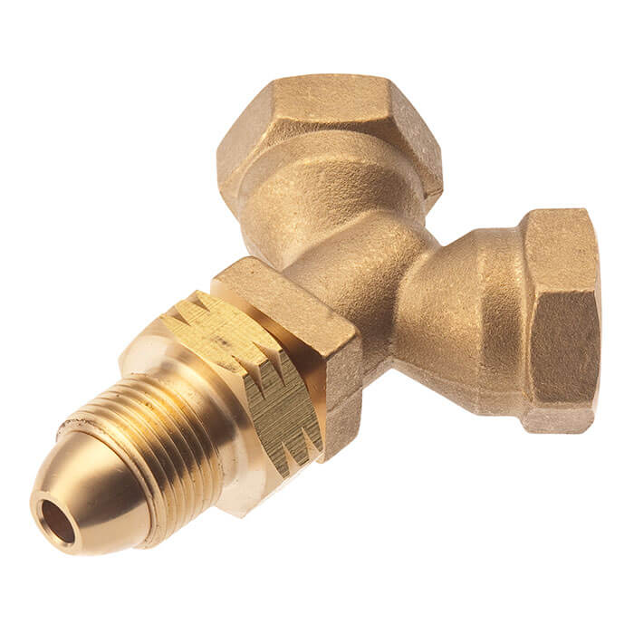

    I have 2 in service tanks 4 years gone on 12 Year tanks (USA Tanks), Canadian gets 10 years , but they sell them a year old or more sometimes ) Auto switching regulators LPG [​IMG] This way there is no tools needed when I need to transfer tanks NOW , just turn on the mini pig that's always hooked up . 2 tanks can be hooked up but only one is supplying LPG. I can gang my tanks as well [​IMG] Sloth
