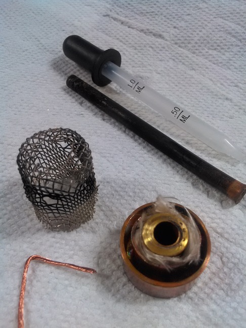

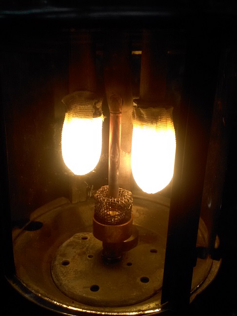

    My older posts here about Coleman kerosene pressure lamps and lanterns didn't have any useful details. I did find some pictures that will be useful to anybody contemplating a kerosene conversion. You can see the remaining alcohol boiling in the preheat cup on my 285 after the mantles have lit.
    285 Preheat cup. It doesn't matter if it's a Coleman lantern like the 237 or a dual fuel lamp like the 139, it's going to need a preheat cup to run on kerosene, unless you have some other external heat source to preheat the generator. Usually, and most efficiently, this denatured alcohol as the preheat fuel source.
    Coleman, in Far East markets where denatured alcohol isn't easily available, invented a preheat cup that will work just fine on kerosene. It came on the Coleman 206, and it's really nothing more than a standard alcohol cup with a wick at the bottom, and a screen that protrudes above the cup. My quick fabrication of one from a stainless steel strainer screen worked just fine, directing a long, nearly smokeless flame to rise nearly the length of the generator once lit. Here's an original 206 preheat cup.
    Coleman 206 preheat cup and frame.
    Other manufacturers (Aida/Pertomax) used torch lighting... which is a lot more fun, but it's a lot of work to get the pressure up. Coleman 238B blowtorch preheater and generator. Coleman used a preheat torch only on the Canadian 238B "Prince" as far as I know. They had a beautiful generator, but you can't beat a preheat cup for reliability.
    Gator 45/70 and Motomom34 like this.

    Lots of details on my construction of a Coleman kerosene preheat cup clone on CCF. It isn't as pretty as the patent drawings, but it works. I can't remember why I left the alcohol preheat cup under the kerosene one. Probably just so I didn't misplace it.

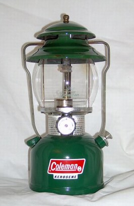

    201 is easy since it's already kerosene. You can practice the preheat and lighting steps on it. The 201 is basically a 200A set up for kerosene and it's generator and preheat cup are a direct swap to the 200A.
