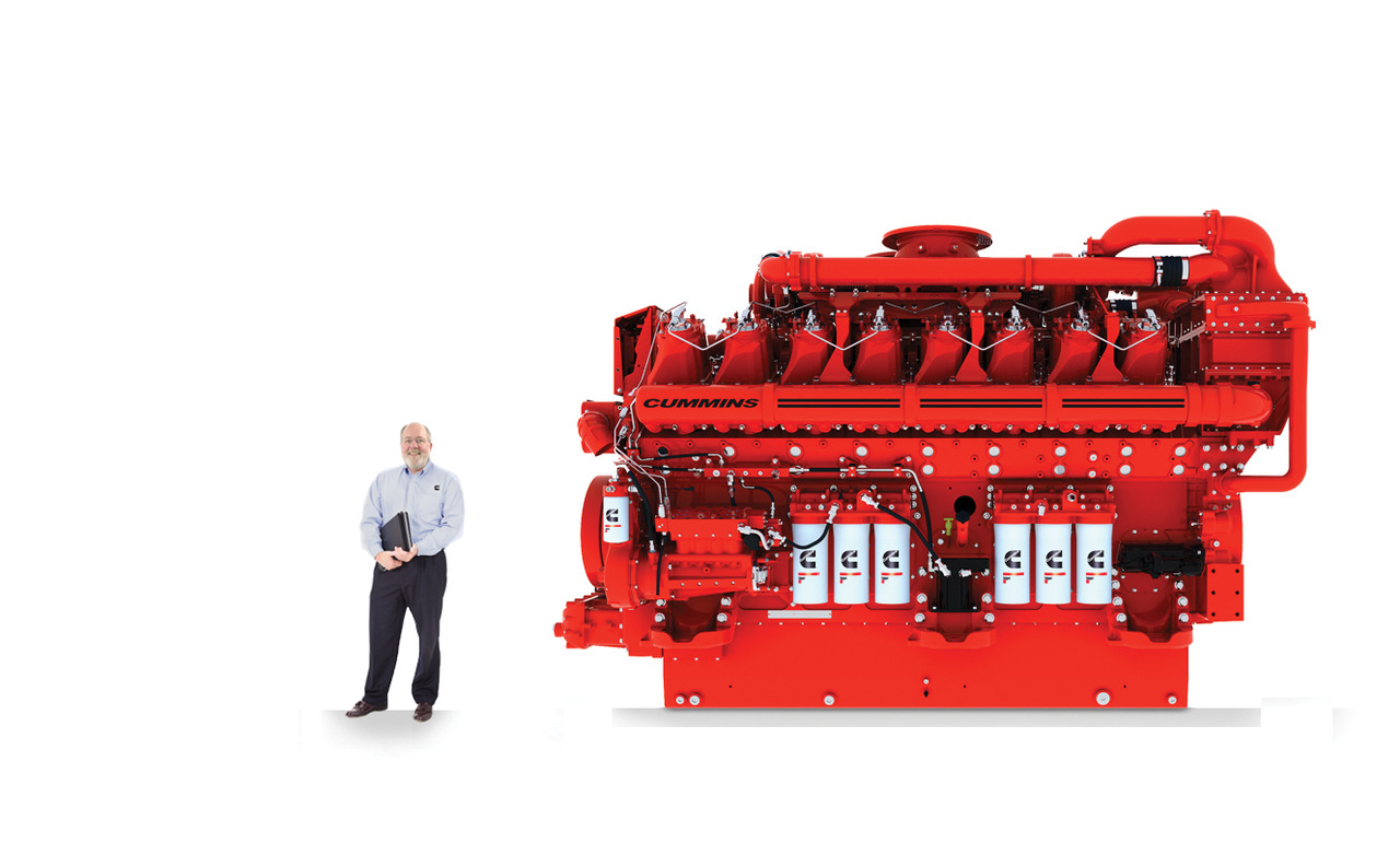

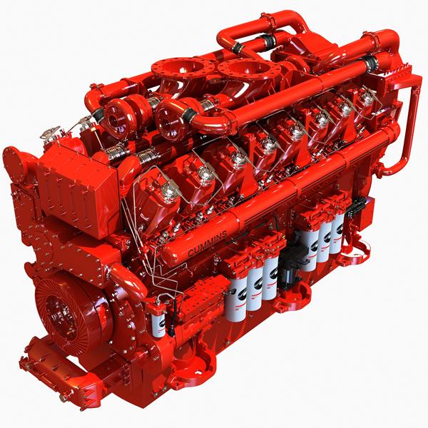

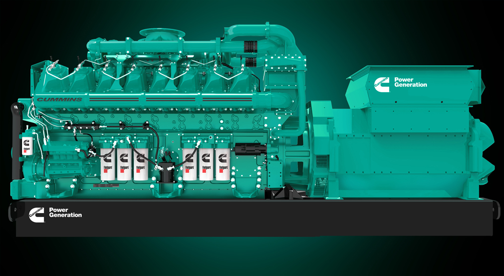

    And then you have this for a large engine:
    Over 4000 hp which may not seem spectacular but it can do at 1800 rpm! That is a big deal in that it can couple direct to a genset for 60 hz power with no speed stepup transmission.
    3.5 million watts!
    AT
