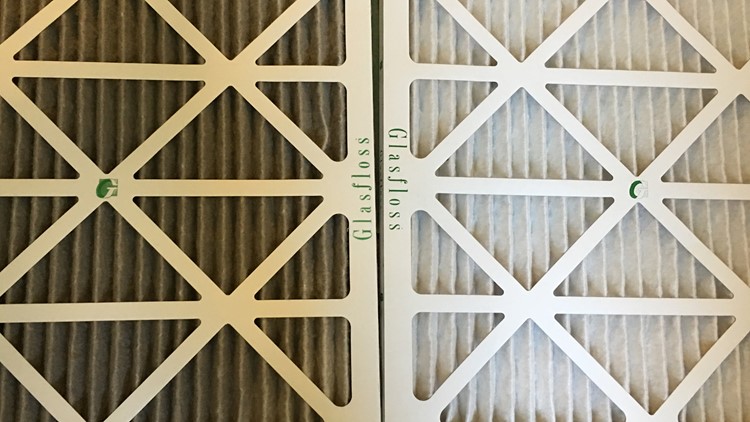

    All you need to do is buy what’s called a MERV 13 or FPR 10 furnace filter and tape it to the back of a box fan. The filters sell for about $15. Don’t worry if you don’t have any tape because the suction from the fan should make the filter stick to the back.

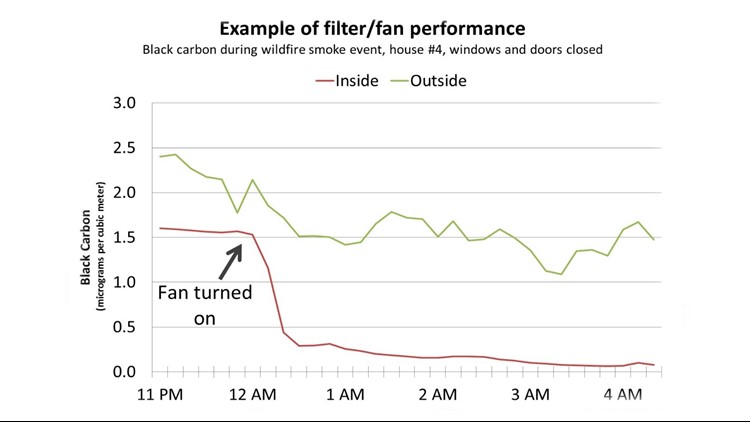

    Last year the Puget Sound Clean Air Agency put one of the homemade filters in a 14’ by 14’ room with all the windows and doors closed. The filter dramatically decreased the amount of black carbon in the room within 30 minutes. The agency says the filter can give you a 90 percent improvement in fine particles.

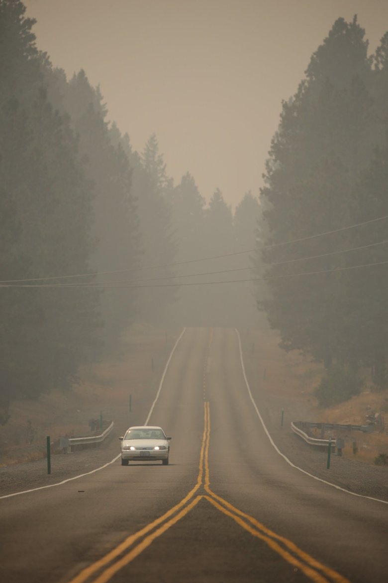

    This is our AO today...... woke up to ash on the vehicles this morning.... :eek:
    If you have to be out in the smoke, a personal mask is very good for protection from inhaling smoke. Indoors.....PITA. ;)

  6. I live where the Mississippi runs west, and local weather people have been commenting on the smoke we are getting from the west coast fires..
  7. Yard Dart
    We are getting a lot of smoke from British Columbia.
    But last night we also had a local fire spring up right down the road, that burned all night.
