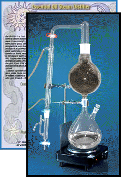

    I keep looking for a good one, not too big not too pricey, getting no love on these goals so it occurs to me, I might be able to build one from Laboratory glass for under $200.
    This one is priced at $499 or something ridiculous
    Here is the link to the individual parts. http://heartmagic.com/eoinstructions.html
    NEED HELP with, what are these parts called so i can order them from a decent lab glass manufacture like this one.
    Laboratory Glassware - Distillation - CTechGlass.com

    I would not use glass flasks and science equipment, just given the amount of meth busts going on, and also because it's not much different from making your own moonshine. We're American, we should be freaking pro's at that by now.
    Also keep in mind, even for a small operation, it will take many pounds of plant material to make even a few ounces of essential oil. I was checking into this years ago, and would love to do it, but decided if you're gonna ride this bull, go big or go home.
    Here's a primo setup

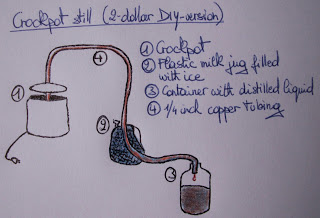

    Rather than going with scientific glass, you might consider building a copper alembic/still, scaled to the kind of production you have in mind.
    The pretty curves in the traditional ones are mostly for looks. You can use copper pipe fittings and tube. It will look more utilitarian and function every bit as well.
    Price? I recently built a still with a 20 gal. pot. I used copper for everything above the pot lid and only spent about $40.00.
    In order to make that ridiculously low price I bought all my absolutely brand new copper fittings as junk copper by weight from a scrap yard.
    If you ultimately decide to go with glassware, you might want to make some custom storage cases. Stacking the glass in an old milk crate just won't cut it. Get a couple of hardshell suitcases from a local thrift store (@$3.00 ea) and pad them out with styrofoam and glued felt or soft foam cut to shape.
    Chances are you'll be glad you did.
    Haunt Google and YouTube until you are well informed, then make your move.
