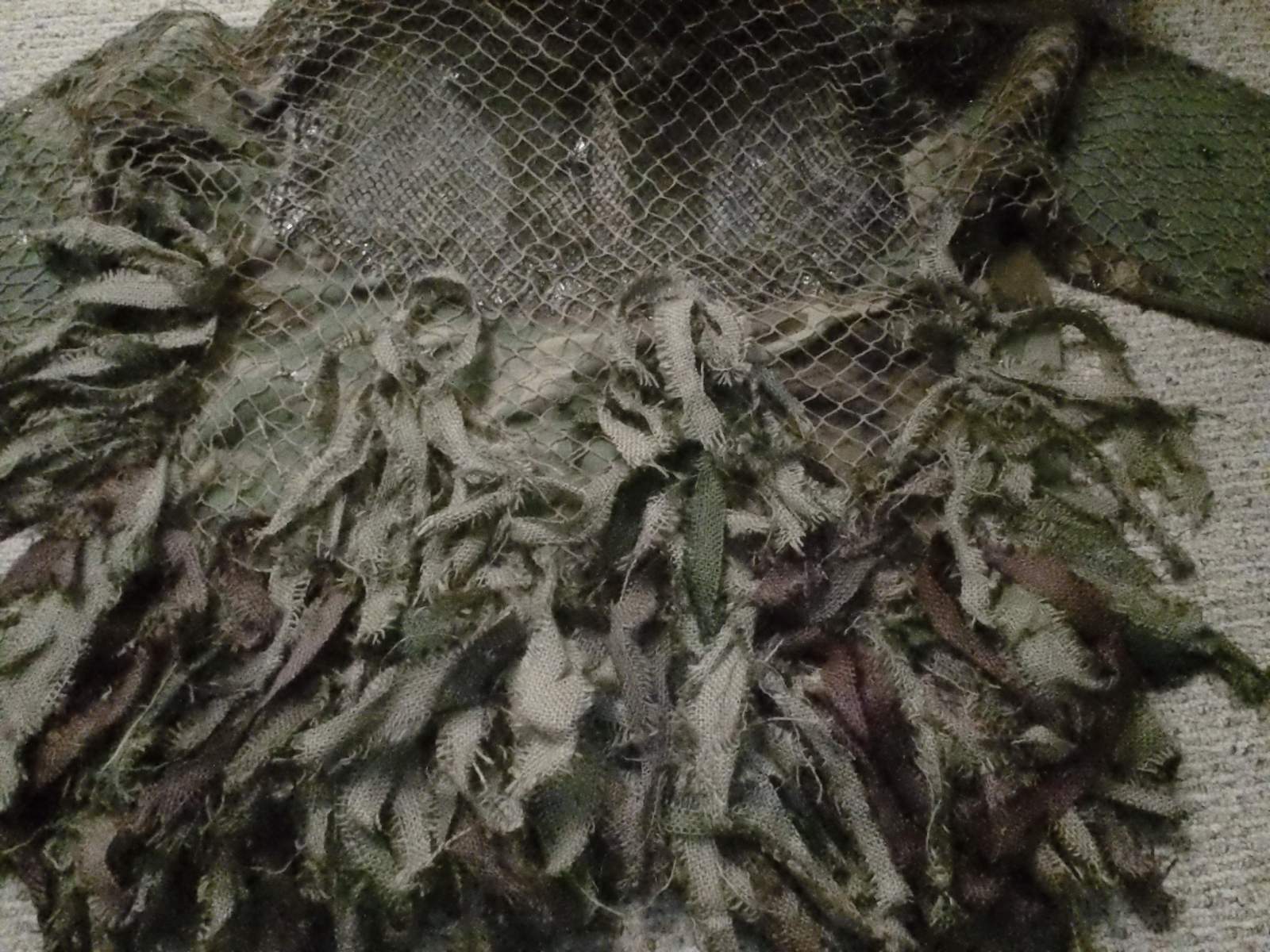

    Anyway, here's the latest pics. It is coming along quite nicely. From the last pictures until now, took only about 1 to 2 hours. I had to cut the strips and tie, so it would be less time just tying. I cut some strips down the center to make thin strips and I also cut them only 3" down and tied them off to make thicker strips in varying places. This should make it so the fill is nicer.
    I am working across for three layers at the bottom, then upward in rows on the edges and two rows in the middle. Then, I will simply fill in as needed. I want to keep the weight down as much as possible, but also create as much fill as necessary.
    A close up of the two center rows:
    A close up of one of the edges:
    The edges are important because you will want to fill in as much as possible. Make certain you spent time securing the edges of the net really well here also.
