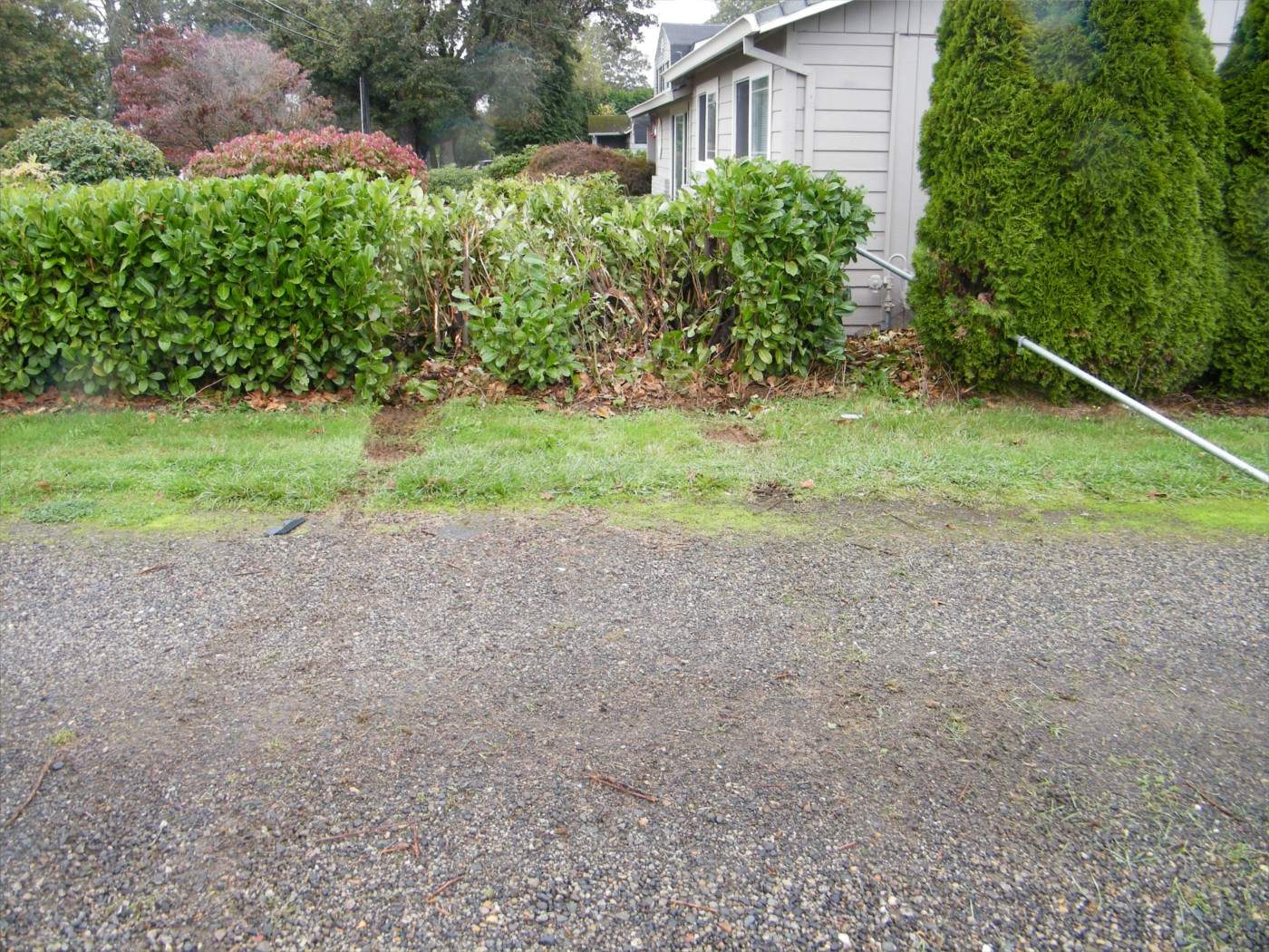

    Way back in the 1950's a neighbor cast his fence posts out of concrete and rebar, mainly to save money. The posts were deeply set, so after he passed and the land was divided and sold, the new owner wound up leaving them in place when he planted his hedge. Fast forward thirty some years when a speeding drunk who was fleeing from police decided to attempt to drive through said hedge and happened to locate one of those posts with his F-350..
    upload_2014-10-18_20-31-12.
    The sixty year old post did get pushed over, but not before doing considerable damage to the truck. It got me thinking that this would be a great way to keep barrier protection flying under the radar if that's part of your defensive strategy, especially in the suburbs. Obviously you would want something more substantial and placed closer together than the 10 feet spacing my departed friend used.

    It definitely gives one some ideas. 5 foot spacing seems about right. Nice rebar reinforced base right at ground level with 3 foot of 5 foot HD tbar fence post extending from base at slight upward horizontal angle where tip is just above or at ground level towards outside of property. (tip it by force of impact and impale the under belly of vehicle). Second pour, rebar reinforced and continuing up 3 to 4 feet, with crossways horizontal tbar fence post extending 3 to 4 feet towards outside of property. Barbed wire may be strung on these to encourage growth of foliage vines. Also in this second pour the extension of tbar fence posts vertical, extending at least 4 feet to have horizontal strung barbwire for same reason as previously. Pressure treated 2 x 4" pieces attached by tapcons to face of above ground concrete bases to string lower 2 to 3 runs of barbwire. Irrigation, temp or permanent should be run to this fenceline to expedite growth of chosen foliage shrubs, trees and vines. Consider something which will grow dense and be evergreen for your area and possibly include edible fruit species or positive medical value, or severely negative poison producing plants. All of usage for survival post SHTF. jus thinkin bout it.

    Personally, I'd put the concrete posts whatever distance apart you would normally find prefabricated privacy fence panels in length. That way, if you wanted to (later on), you could substitute privacy fence panels for bushes/plants. It means making them 6' high and 8' apart, which some people would worry is too far apart for security, but that's where the next part of this plan comes in.
    While you're digging down for the footer of the posts (I'd say go at least a few feet, to get below the frost line and prevent heaving from freezes), making forms, setting rebar and pouring concrete, add one small feature to each post: a piece of pipe, running horizontally through the post, parallel to the direction of the future fencing (corners should have a quarter circle piece), about halfway up from the ground to the top of the post, ~3' up.
    Why? Well, after you've allowed your new concrete posts to cure, and removed the forms, you'll now have a line of fence posts with the ability to run a cable or chain (depending on the size pipe you use.....cable should, of course, require a smaller piece) throughout the entire length of the fence. Personally, I'd prefer cable, but if you have a bunch of chain readily available, you might want to go that route.
    The advantage of adding this is that now any vehicle that wants to run through your fence (or bushes) is going to either have to sit lower than an 80's Fiat or MG convertible (and trust me, they sit low!), or will have to take down half your fence, in order to get past that cable! Unless they're driving an M1A1 Abrahms main battle tank, they might take out a couple posts, possibly even 4 of them......but they're going to find out, rather quickly, that the cable is stopping their vehicle cold, before they get very far onto your property! Go ahead, let's see how well you can take out X number of feet of well planted, rebarred, concrete posts, with a 3/4" cable connecting them all together! ;)

    Of course the operating principle here is reinforced concrete post deeply set. If they are not large enough they will easily be broken and if not deep enough easily pushed over. If not close enough together then may allow a vehicle to pass through.
