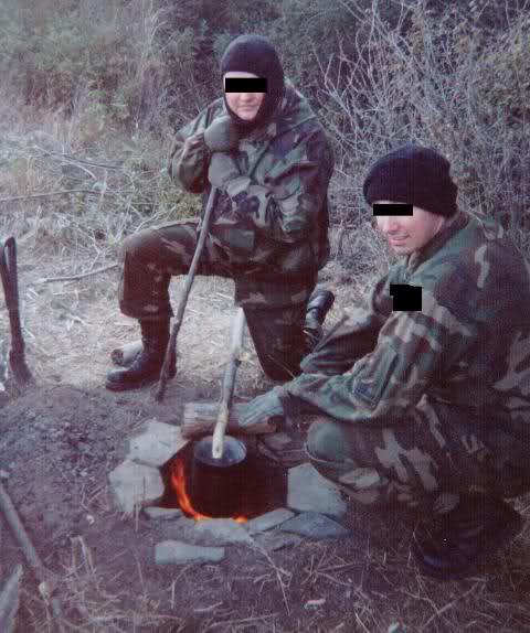

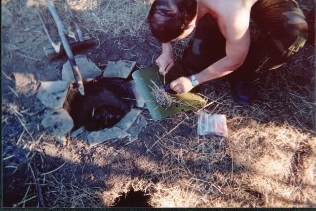

    If you are wanting to hide a fire, or to use the least amount of wood possible, dig a Dakota fire hole!
    How? First, you need a reason for the fire, cooking, boiling water, whatever the reason, you now need a cooking vessel. Lets just say for grins, you have a one gallon tin can. Dig the hole just slightly larger than the can so that it can be lowered down into the hole. this implies that you built a handle on the can to do this. Once you get the hole dug down, go upwind and dig a smaller hole at a angle down to the bottom of the hole.
    The theory is that the wind will travel down the hole and provide the oxygen necessary. Since there is an abundance of oxygen, the wood will burn hotter, thus less wood necessary and less smoke. Works like a champ!
    Notice the premade tools off to the side for operating the cooking pot. And yes, the magnesium starter works. This was taken the second day of field craft during Survival School. Notice the draft hole for the fire pit.

    Just found this pic. It was the next morning as we were boiling the first pot of water for a face wash and some acorn tea. By product, warming fire.

    Good method, I hadnt heard of doing the second intersecting hole before.
    Two other tips for any who may not know or think of it, first would be to use the driest wood possible. The thing that will show a fire the quickest is the smoke. Green or wet wood produces a lot more smoke than dry wood. The second would be to build your fire under folage. Make sure there is enouph room over the fire that you arent catching the tree on fire, but going up through the limbs and leaves of a tree will help to disapate the smoke enouph that it is much harder to see.

    Way back when I was a pup, ( :oops: and later when I got interested in the fur trade) a similar technique was used for small heating/cooking fires in teepees and tents. Instead of the intercepting hole (tough to do in sand) we used a small trench out to the side and put a rock (or GREEN log) over it for a sorta bridge. The same effect, works well. Also (to repeat, use DRY wood, squaw wood is best) and start SMALL. You will be amazed at how effective it is, and how much cooler the cook will be.
    The boy scouts used to have a thing called "hot pot tongs" for lifting things on and off fire pits and grills. Ideal for the application, should be in any kit used for camping.
    Get one, or fake it with a pair of water pump pliers. Makes getting your tea bucket out of the hole a lot easier.

    Ghrit, you are correct, you can dig a trench and cover it with rocks or wood. The only problem I found with that method is that the draft hole tends to be big enough that the coals start backing up into the draft hole and you have to clean it out more often.
