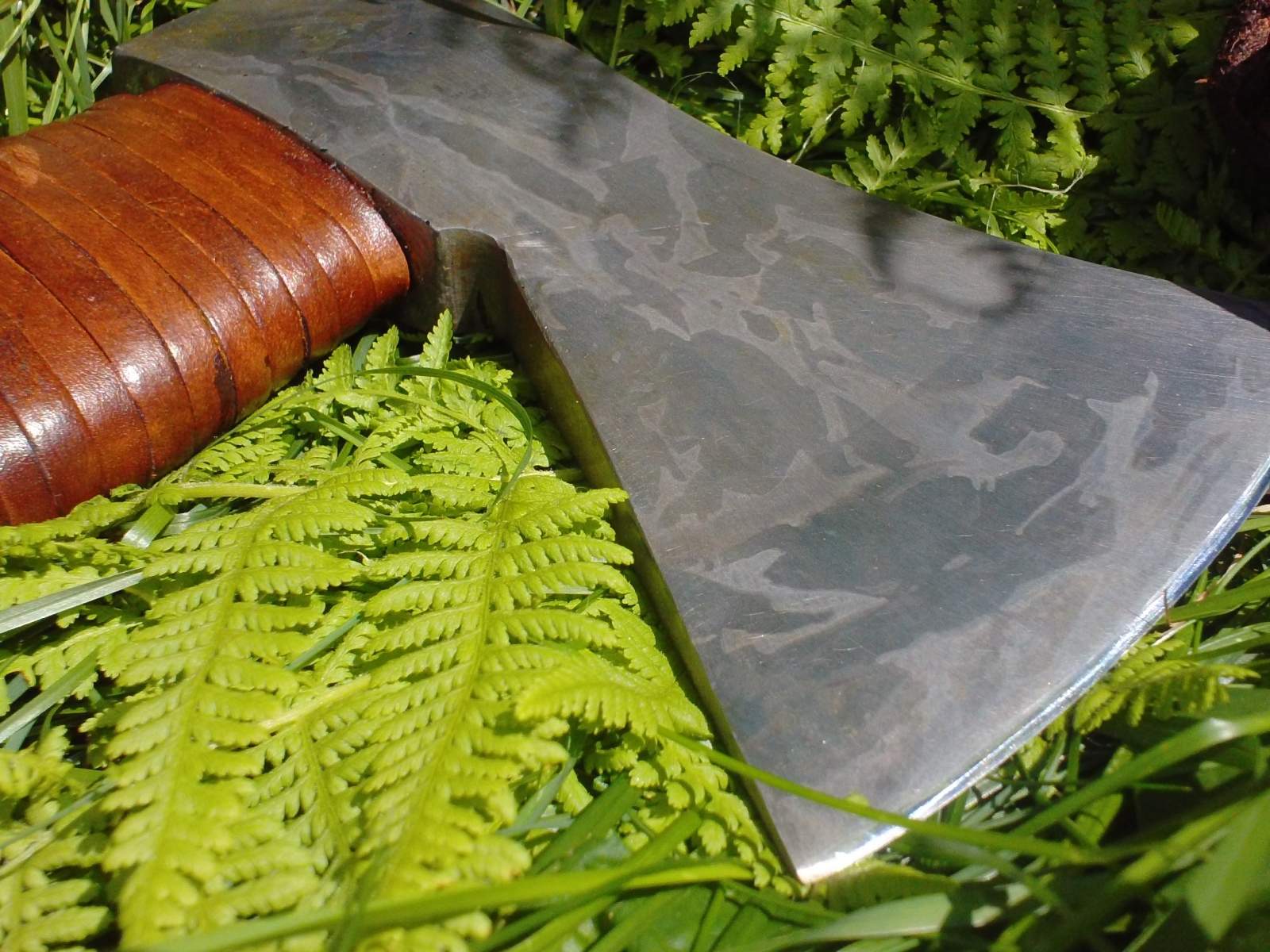

    I got this ax I think from my grandmother in 1998. Grandma used to have a big house heated with wood stoves. I got it then some one left it out side for a year or 2 while I was in Japan.
    Last time I cleaned it up when I put the last handle on it in 2009 or 2010.
    All it took was a flap wheel paint stripper wheel and one of those "work sharp" knife sharpeners.
    20161114_194017.
    It's a little better and sharp enough I could slice a deer open with it now.
    Needs a little more work before I put another handle on it.

    You have an electric sharpener? Have you ever done it by hand? Nice job, that edge is shining.

    For non electrical tool sharpeners I have used are files, soap stone, the V style knife sharpeners.

    Soak it in vinegar and lemon juice for a few hours to form a patina and possibly bring out the grain/pattern.

    I hard faced the flat side with high chromium and manganese alloy rod. Has very good abrasion resistance and good impact resistance.
    I had some that are even harder than this, chromium carbide, but figured it might be too hard and brittle.
    My 8 inch grinder barely does anything to this stuff.
    20161118_171323.
    If anyone makes knives they should try infusing some of this stuff into the edge.

    It is way more than possible for a striking surface or cutting edge to be too hard such that it'll chip. I do NOT know how hard that particular rod will leave behind, but please do NOT forget to wear goggles when striking metals and ceramics.
  13. oil pan 4
    Yeah it's quite a bit harder than tool steel.
    The pack of rods is pretty vague on exactly what the hardness should be. It didn't even have suggested polarity.
