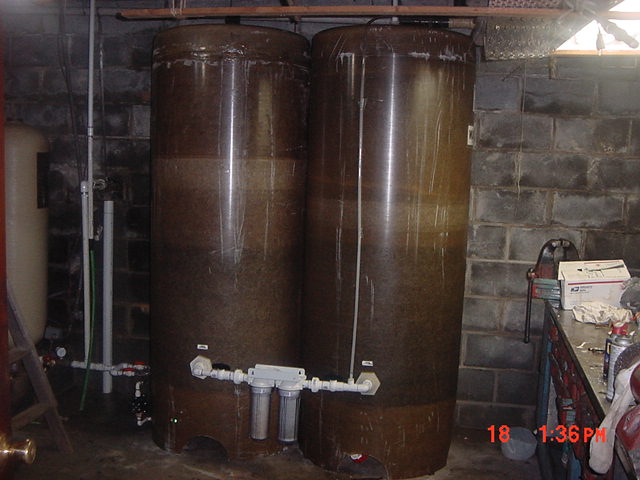

    About a year ago got my back up water system up and running like I wanted it.
    I have good water from the well but it is limited it runs out quick. This was going to
    be for back up only. But it worked so well that It's about all we use for water in the house.

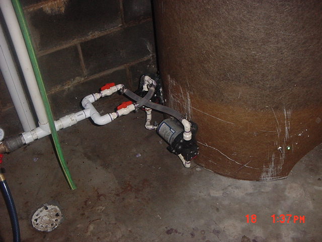

    I used surflo on demand RV pumps. I tied this into my existing pluming and made use of
    the accumulator tank. I get about 9 gallons of water before the pump kicks on.
    It runs off the 12 volt batteries used my solar system. No grid needed.
    That hose you see running up the first tank is clear hose (sight glass)
    I'm running two surflo RV water pumps.,, I ended up only running one at a time it's all I need having two
    really doesn't help that much. Other than quicker recovery

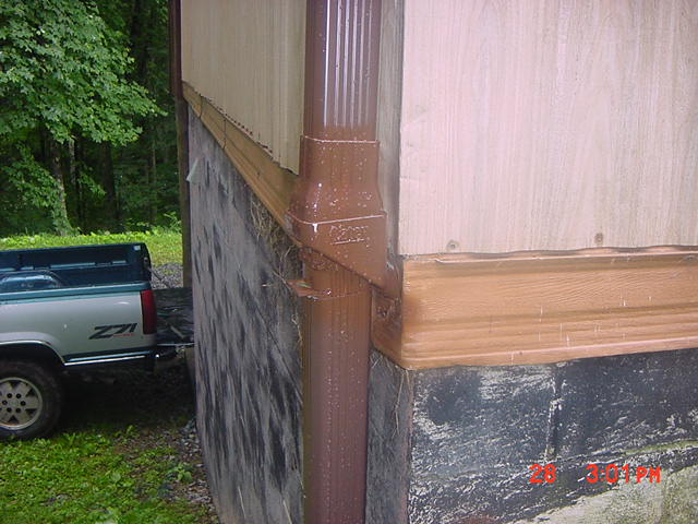

    When I turn on the rain water valve it comes out the green hose until I turn the valve for the tank
    to receive the water that way I can take a sample of what I'm getting before it goes in my tank.
    To make sure the nasties are all washed off the roof. I have never needed to use this so far
    but I have tested it and it seems to work as planed.

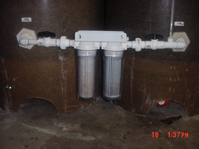

    The water goes into the first tank then through the filters and into the second tank then through the
    pump and into the house pluming. If you look real close you can see a drain valve on the bottom of the first
    tank. I figure that if I get any sediment or anything nasty in the bottom of the first tank
    I can flush it out there. It's 3/4" big enough for that
    If you look you can see a switch and a small green light. The light comes on when the system is "ON"
    I'm going to install a small light upstairs that comes on when the pump is running. Just to help
    keep an eye on things

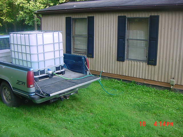

    I have few different ways I can fill it I can use my truck and tote and fill it with city water
    I installed an out side filling tube or I can fill it a little at a time from the well I have now
    I have spring that I can fill it from or as a last resort I can catch rain water
    Next I would like to install a propane tank less water heater
    I'm thinking that when the grid goes down having running water hot and cold and electricity for
    lights and radio that it would be a big convenience. Yea,, Hot shower with no grid.

    What filter elements are you using in the two cartridge filters?

    The carbon is good for chemical removal. However, neither of your filter elements will do much for microbial contamination. Bird, bat, squirrel, racoon or insect poop on your roof can be contaminated with bacteria or viruses and your system won't effectively treat that for you. There are sub-micron filters but I have not found any in a standard cartridge size. Black Berkey elements can be rigged up to provide a microbial filter stage. Probably a better option would be to add a UV purifier post cartridge filters to clean up the microbes. UV has been discussed on SM several times by atleast BTPost and myself and probably others. There are some 12vdc UV systems available that would pair well with the Surflo pumps (I have those too.)

    That is what the UV Tank is for.. It will Kill just about ANYTHING in the water that flows thru the Tank...
