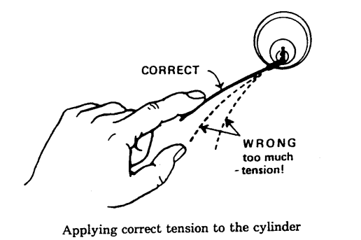

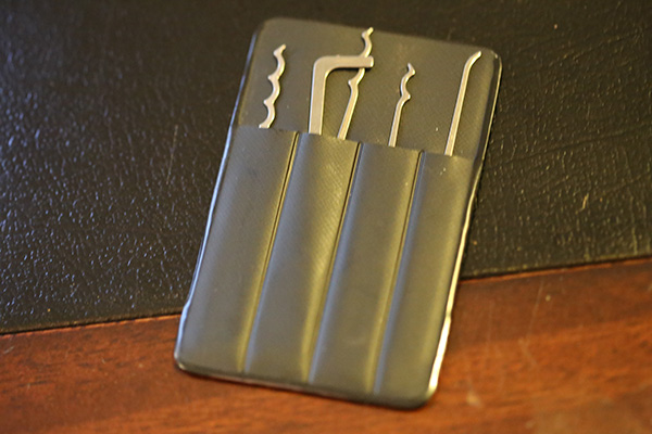

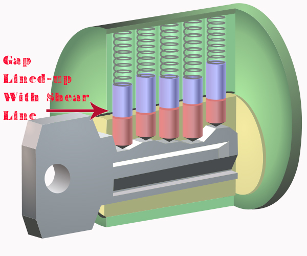

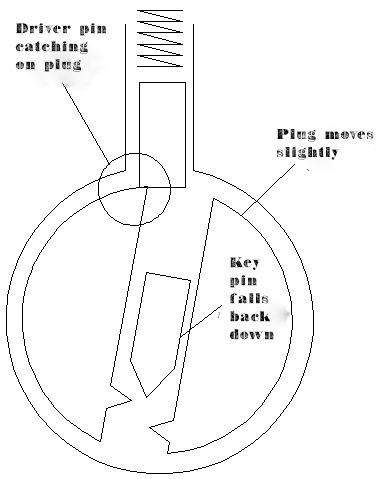

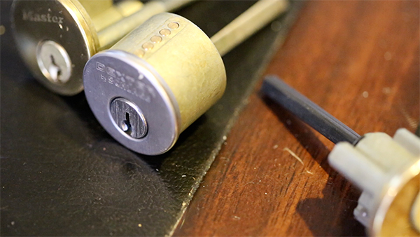

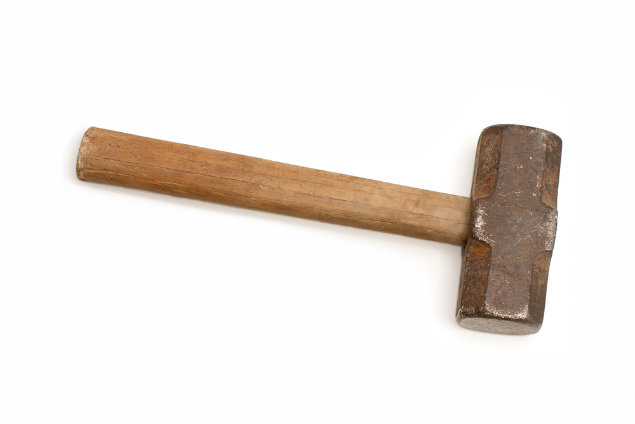

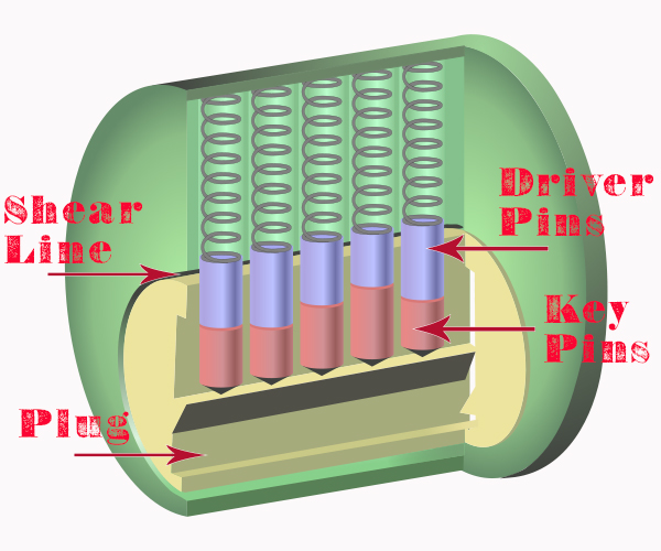

    So the SHTF and in the commotion you lost your key's to everything.... other than being smart and having a set of keys stashed elsewhere, how are you going to gain entry into that door of yours or your parents if they fail to answer... or open that chest, cabinet, what have you... and don't tell my the crowbar is the magic key... we know it is ;) But you may not want to damage the door or whatever. So here is better way to get through that lock and the tools that you may want to have on hand. And a new skill to master that may be useful for you at some point.
    How to Pick a Lock | The Art of Manliness

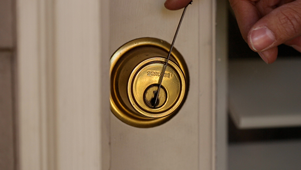

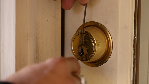

    For Padlocks...

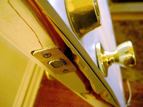

    For Dead Bolts and Conventional Mechanical Door locks... My foot and about a three foot head start...

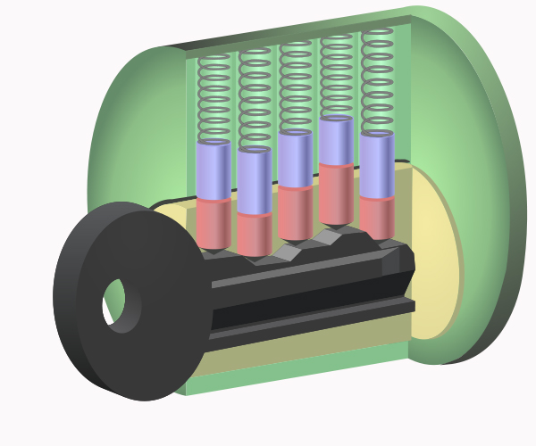

    That master key business is called a hierarchy, and is set up all at one time. (We do this). It means repinning locks to work with several different keys. Each key uses a different lifter pin arrangement so that the sheer line is straight regardless of which key is used. The higher the security level, the fewer lifter pins.

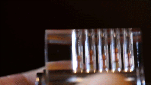

    I have the "Dyno Kwick Pick" and it works really well. The best part is, it looks just like a pen and can be clipped into your pocket. Easy to use, very reliable. I picked a deadbolt in about 15 seconds and I am not too adept at lock picking.
    This is a great video on lockpicking -it's an introduction for beginners and has some helpful information I found useful.

    Another helpful video on the inside detailed workings of a lock:
