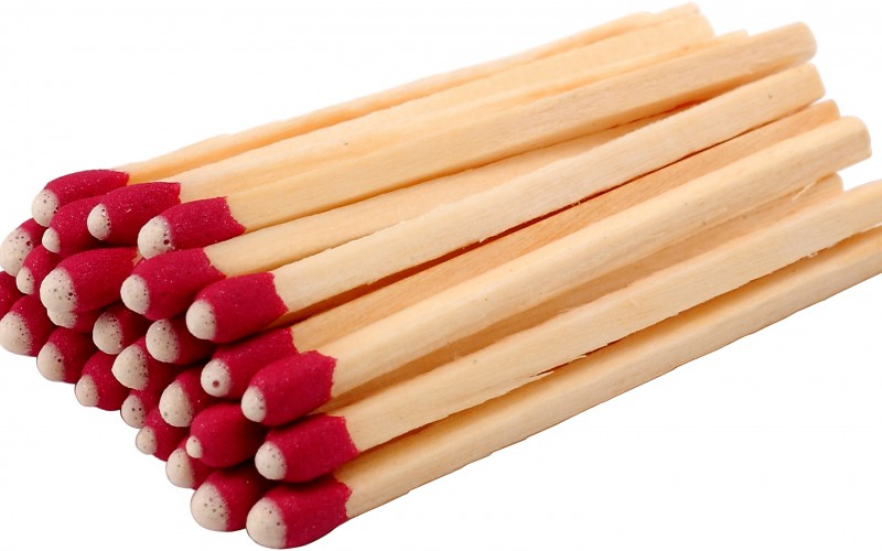

    Stick matches are easily compromised if old or even slightly wet. And while it’s better to carry several inexpensive disposable lighters and/or magnesium sticks, knowing how to make your own survival matches is a handy skill to possess.
    Wax-coated matches
    Here are the materials and tools you need to create your own waterproof matches:
    • A box of large, wooden “strike on anything” stick matches.
    • A tin can.
    • A chunk of paraffin canning wax or a couple wax candles.
    • A couple yards of yarn, cotton string or sewing thread (for making a small tinder-wrap).
    • A scrap piece of work board you don’t mind wax getting dripped on.
    • A few paper towels or newspaper.
    • A pair of needle nose pliers, a multi-tool, medical forceps or other gripping device.
    • A boiling pot and water.
    • A stove or campfire.
    The process
    Rolling your own waterproof survival matches is not difficult.
    • First, wrap the handle stick of a batch of matches with cotton string, thread or yarn from the match head down, about one-half the handle length or stick handle. You can use a drop of superglue to tack the ends rather than worrying about tying knots to hold the string to the tiny stick.
    • Put a pot of water on the stove with two or three inches of water and heat until boiling, then turn the heat down until the water is remaining just hot enough to keep the wax in a liquid form.
    • Place shaved or chunks of wax in the dry tin can and set it into the hot water, much like a double boiler for melting chocolate. Place enough wax chips in the can to keep it from tipping over in the water.
    • Maintain the water heat just high enough to make the wax in the tin can melt and remain as a liquid.
    • Be careful not to allow any water droplets to fall into the liquid wax, as it may cause a splashing, much like water dropped into hot cooking oil.
    • Using pliers or medical forceps, grip the handle end of a match and dip it into the wax deep enough to cover the tip and the tinder-wrapping.
    • Hold the matches over the can to let any drips fall and then allow them to cool enough to lay them out on a paper towel or newspaper without sticking.
    • Allow your batch of super matches to cool long enough to let the wax turn to solid once again.
    Safety tips
    Using fire, a pot of boiling water and a can with hot liquid wax requires paying close attention so as not to burn yourself.
    • Keep the liquid wax away from any direct flame source. It is highly flammable and has been known to result in flash-over fires.
    • Use extreme caution when moving the pot of water and hot wax off the fire, being very careful not to slosh any of it on yourself.
    • When using waxed or nail polish matches, make sure you stay alert as they sometimes flare up more than expected and require additional force to make them strike.
    — Frank Bates
