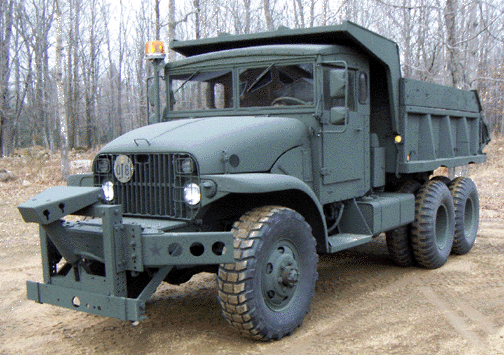

    I've met this guy (Tom)through our bike shop and swap meet,he was the alfa romeo race team manager and head mechanic; he also produced a famous complete road race car but I don't remember what it was called: He's located pretty close to me here ( and really good people)Check them out :
    http://www.alfaheaven.com/ they rebuild all kinds of surplus vehicles,
    http://www.alfaheaven.com/MilitarySection/Accessories/Trailers.html
    [​IMG] http://www.alfaheaven.com/MilitarySection/WhyBuy.html
    http://www.alfaheaven.com/MilitarySection/6x6 Trucks/6x6Gifs/141FrtRtLo.gif
