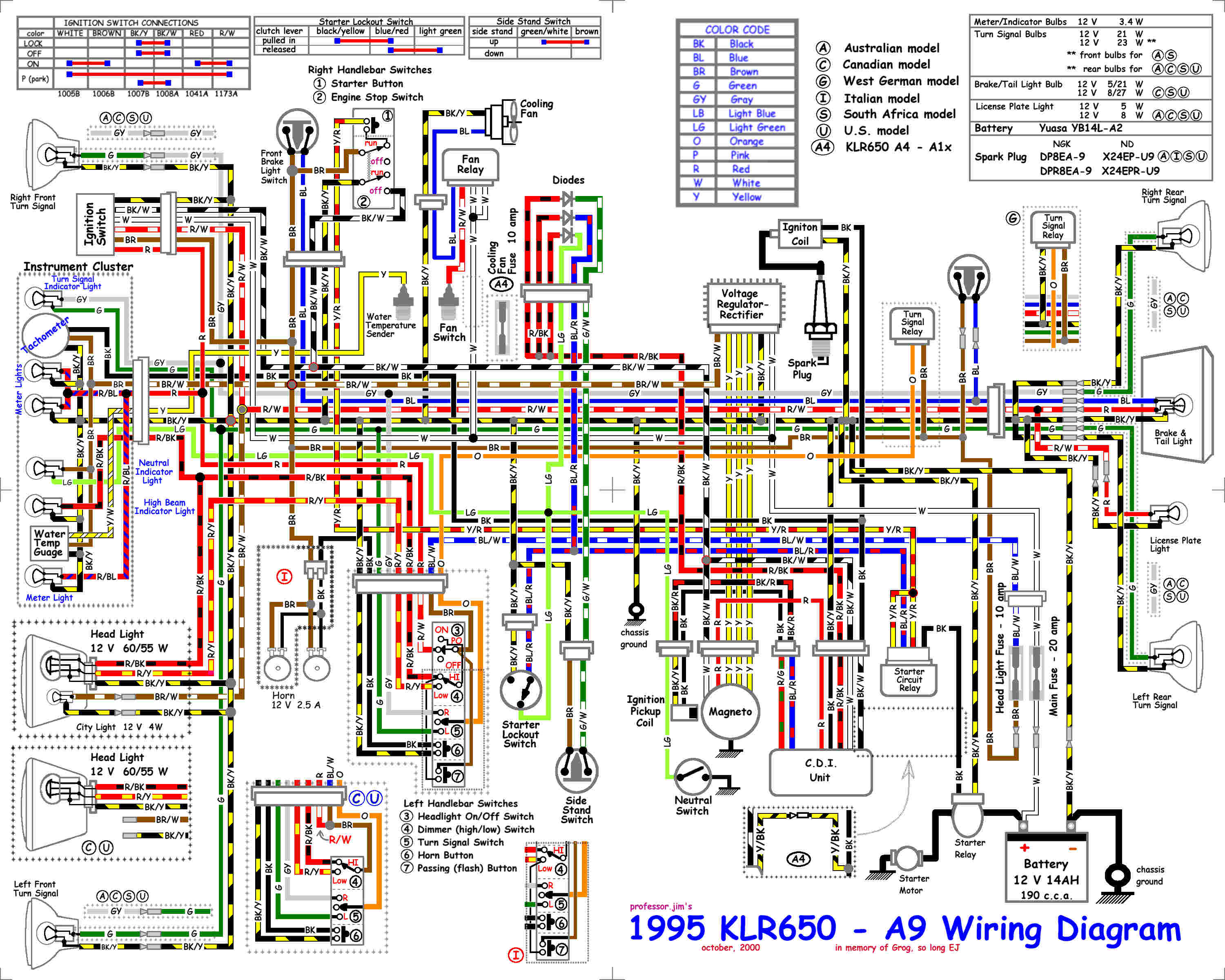

  13. Quigley_Sharps
  14. Quigley_Sharps
    I see the CDI, Rectifier, coil, what about the sensors and relays?, like the crank sensor?

  16. HK_User
    Most sensors are hall effect type and maybe some of the 2- wire variable reluctance sensor or other type of solid state device, so yes.
    Relays? Important ones such as start or coling fan.
