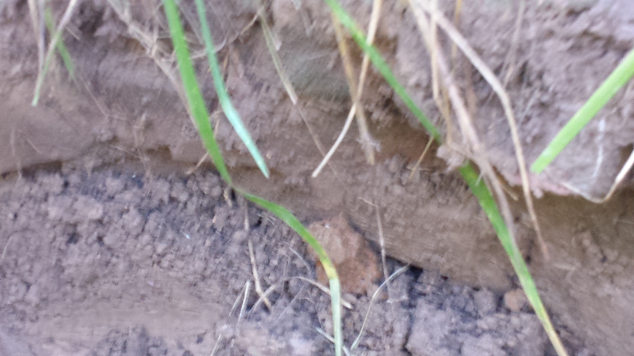

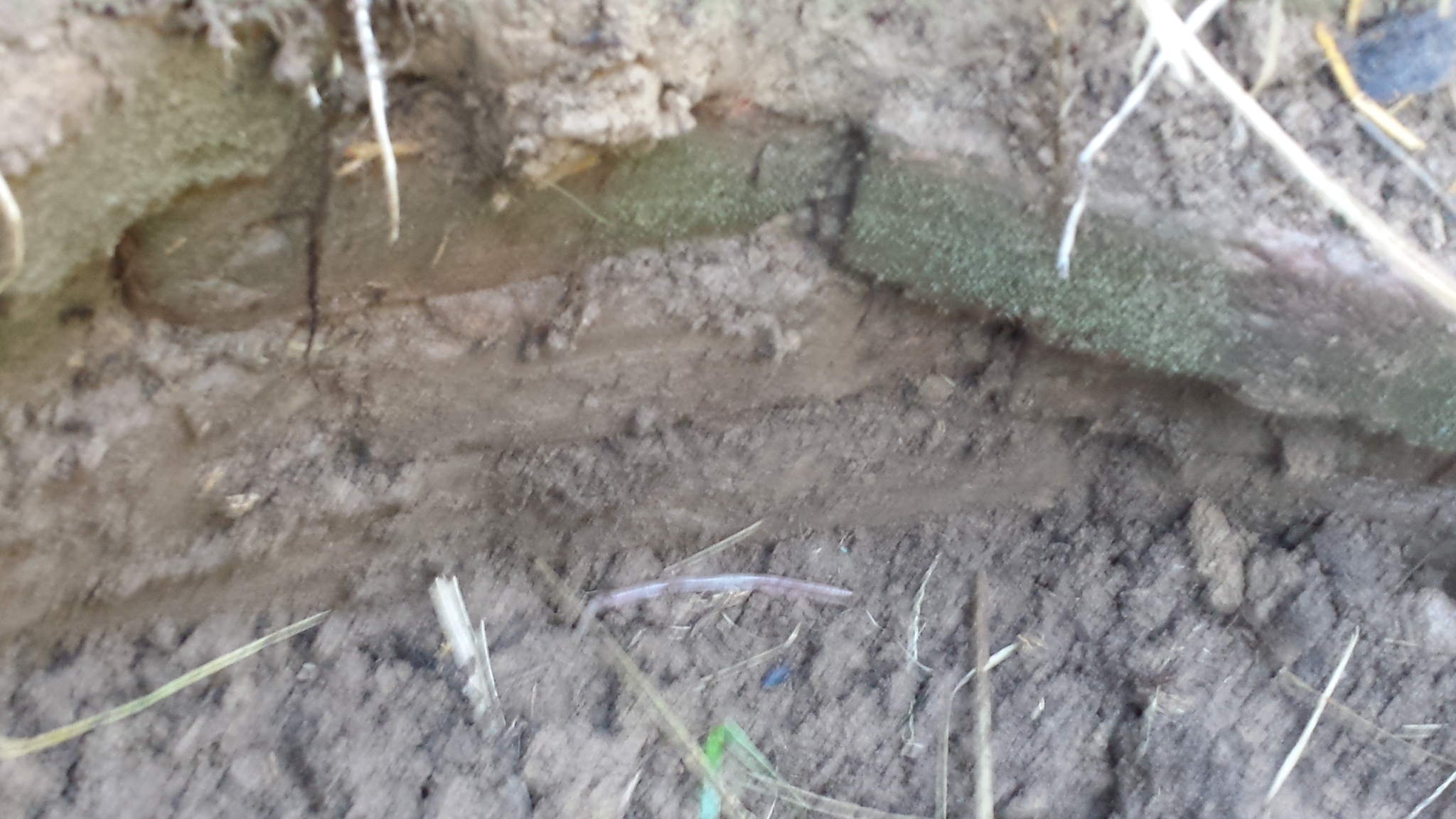

    Well (and that can be a deep subject), when I was clearing the grass back to back fill it, I noticed the hole was round and lined with bricks. I couldn't see any mortar between them, but they were angle cut so they would form a circle.
    [​IMG] [​IMG]
    I dug down a little bit and noticed that it sounded hollow, so I'm not sure what was used to "cap" the "well" but I couldn't dig deep enough to either break through or find what was covering the well.
    So, should I just pull the bricks (I have uses for them and free/repurposed is great) and back fill, or would this be "the" place to have a well driller put a well? While not the most convenient for where we intend to build, it has great solar view since we'll be off-grid and it is close to centrally located where we'll need water.

    You might, however, break through that existing cap, let the dirt settle, and drop a bucket on a rope, to sample what is there, and have it tested. That might help you decide if it is worth the money to reopen it.

    Personally, I'd dig and/or probe a bit more and figure out for sure what you got there. You said the ground sounded "hollow" there. You could have a dug/bored well that is 3 feet wide and 30 feet deep. Filling on top might overload the cover and it could all cave in when your tractor drives over the fill. You need to know for sure. And who knows, you could have a well that could be good for irrigation if nothing else. And even if there is bacteria, filtration and UV treatment could still yield a good second water supply with not much cost.
