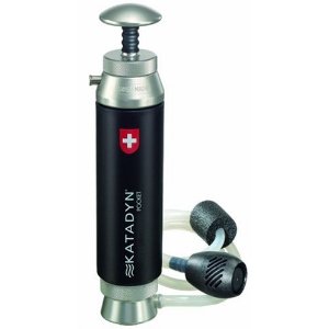

I use the Katadyn Pocket Water Microfilter almost exclusively as my main filter. Cleaned some pretty mucky water from stagnant puddles from time to time too on some deep backcountry treks. It's a Marathon ceramic filter that is cleanable and the whole thing is built like a tank. Highly recommend if you only want to buy it once. I have a few extra ceramic filters Katadyn Pocket Replacement Element as well but unless I crack one in freezing weather, can't see that I'll ever need to replace it.

...between cleanings. You can't hurt this filter but like pointed out, the more pre-filtering you do on any water filter, the better the flow and longer you can use it before cleaning the filter. The Pocket takes about 30 seconds to clean in the field.

Believe me you cannot go wrong with anything from Katadyn....It is simply the best had one for years. It truly is hard to wake up some morning to find a member of your family sitting on the toilet writhing in pain due to cryptosporidium, Or one of the other nasties that makes water its home if you choose to use a product that is not quite up to standards that of katadyn...........The only other filter I might even consider to use would be Steripen but your still looking at a good outlay from your wallet.
I just bought the Pocket filter and a Steripen traveler (for viruses), One for running streams and both for standing water. I also got the charcoal filter, might as well have great tasting water.. I have read that it isn't needed if you preflow your water by 1/2 liter before actually filling your bottle as it states in the instructions. I have the Modgear water bottle pouch from Cheaper than dirt: MOLLE-011 - ModGear Black Water Bottle Pouch Padded Main Compartment Zippered Utility Pouch Fits everything, and has a front pouch to hold the cleaning gear, the coffee filters, and misc stuff. Pretty cool, thanks Melbo, your opinion sealed the deal.
