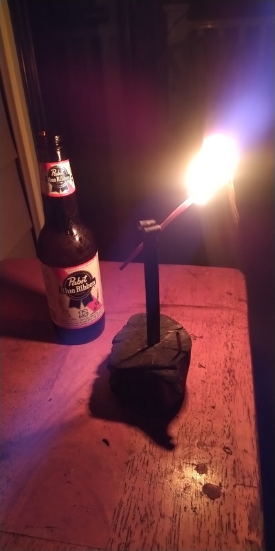

    This is what you do when you have no time to make things and your welder is too busy to make a rushlight holder from scratch. I took him an old pair of pliers (free) and these old pictures.
    ...and he made this. Well not exactly like this. I had to tweak it a bit, soften the edges, squash the jaws parallel. I'll still probably thin them down by about half, but they work.
    When it's finished I'll wet it and throw it out in the yard to weather appropriately. ;)
    IMG_20250416_212717.
    I had to sacrifice another pair of my good pliers that look the part already. He'll straighten, twist and curl it to be the second of a pair. This was the deal I made with the wood turner who made me these nine bases.
    IMG_20250328_151136.
    I can keep seven of my choice if I make him two complete rushlight holders with candle cups. I'm even throwing in the beeswax candles and will strip a sample rush for each.
    I'm hoping I can work a deal with the real blacksmiths at the museum to make me about five rushlight nips of different styles if I give them their pick of the remaining seven bases.
    I'm giving up (L to R) #2 and #9 in this first round.
    They match the mass of the two modified pliers well and will look right and function perfectly. I burn mostly lighter pine splinters since they're everywhere here in Eastern NC and require only the labor to split them.

    Not sure what all you do ,, but you said something about taking stuff to your welder ,, get yourself one of them Harbor Freight 130 dollar flux core welders ,, you can do a lot , without waiting on someone else to do it for ya,, I'm no welder ,, by no means ,, but it's a cool little hobby ,,

    It wasn't an electric welder I needed for this project. Just lots of heat and a hammer. Oh, ...and time. That's the thing I have the biggest shortage of. I found that my kerosene plumbers furnace made a decent forge and heated the jaws up nice and red so I could squash them parallel. [​IMG]
