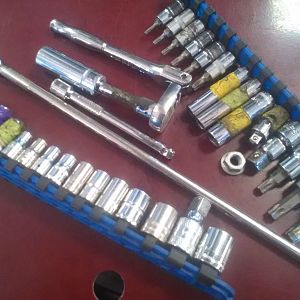

    Many of my favorite tools have tape on them to add grip and hold the occasional screw. Others have some factory knurling for grip, but I've found that some dried rubber cement works better, and can be applied where you need it. That grubby looking T20 bit happened to get some on it during a job, and it was like magic! Instant grip instead of slippery chrome. Wobbly sockets that
    are too wobbly get the tape treatment. Bright colors also make them easier to find when dropped down inside a dash.
    Cruisin Sloth, Meat and Gator 45/70 like this.
