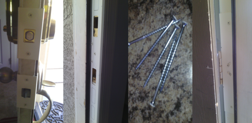

    Having lived in apartments for years before getting a place of my home one of the first and easiest modifications I would do was to replace the screws in the hinges and the strike plate for the door lock with stainless steel 4" long screws. I would also replace the strike plate with a reinforced one and add a deadbolt to the door if it did not already have one (pending landlord's OK).

    Yes, you are looking for a deadbolt with an extended "throw" that mean how far into the jamb it goes. They are good, but it is the jamb that will fail. You are better off. Replacing the keeper screws and installing it with 6" long drywall screws or similar screws. Just make sure the heads will fit the keeper holes or go to a heavy duty keeper. (The latch plate the bolt goes into.
