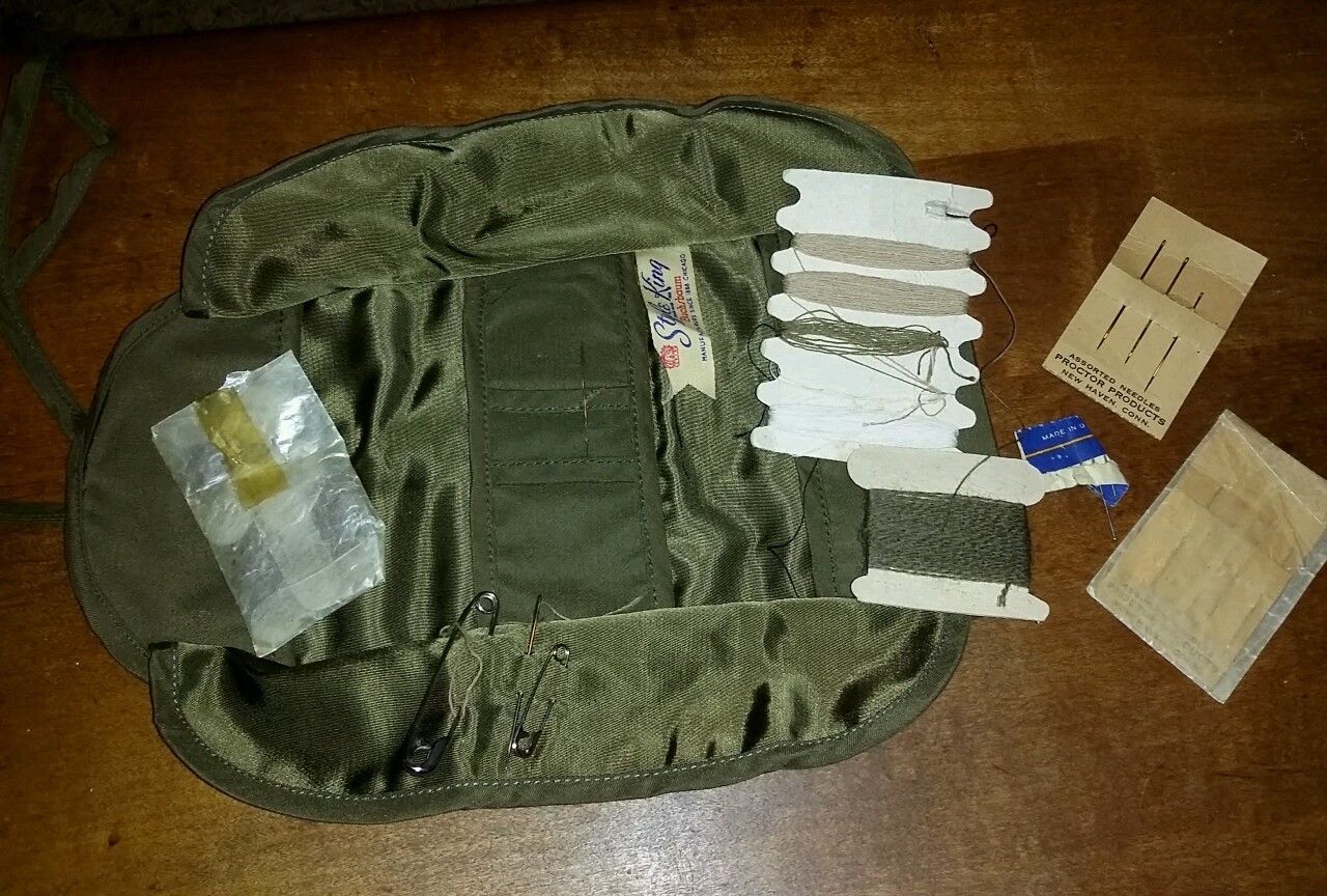

    I have a Vietnam vintage housewife, which I still use from time to do running repairs, replacing lost buttons and so forth.
    this is an example of a military sewing kit (aka housewife), though it wouldn't be too difficult to fashion one from scratch using bits of an old shirt, or a patch pocket from old army fatigues that are now beyond wear or repair.

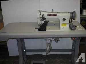

    When sewing with heavier thread and materials like heavy canvas, webbing, etc. then an industrial machine is generally required. My big machine is like this one.

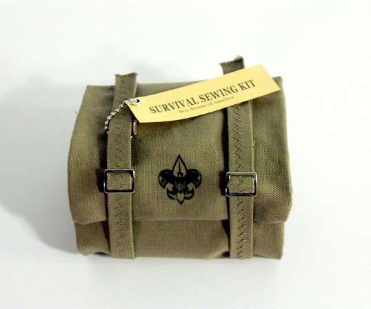

    Via:Miniature Haversack Stitching Sets : Survival Sewing Kit
