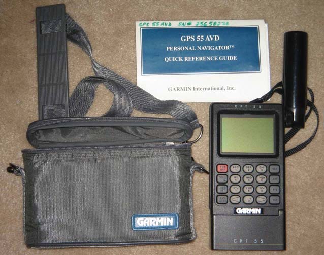

    I have an older, way older Garmin GPS 55.[​IMG]
    And an early Garmin 62.
    I bought a Garmin etrex 20 because it was small and relatively cheap for mountain biking.
    The etrex 20 boots and finds the satellites faster in my garage faster than the Garmin 62 outside..The etex 20 uses both the USA GPS sats and Russian GLONASS constellation.
    If I attach an external antenna to the GPS 62 it finds the US GPS sats outside about as fast as the etrx 20 does inside the garage.
    Going forward I will not purchase a GPS that does not look at multiple GPS satellite constellations with an SD card slot.
    Galileo (satellite navigation) - Wikipedia, the free encyclopedia
    Some modern receivers are able to use both GLONASS and GPS satellites together, providing greatly improved coverage in urban canyons and giving a very fast time to fix due to over 50 satellites being available. In indoor, urban canyon or mountainous areas, accuracy can be greatly improved over using GPS alone. For using both navigation systems simultaneously, precisions of GLONASS/GPS navigation definitions were 2.37—4.65 m with mean number of NSV equals 14—19 (depends on station).
