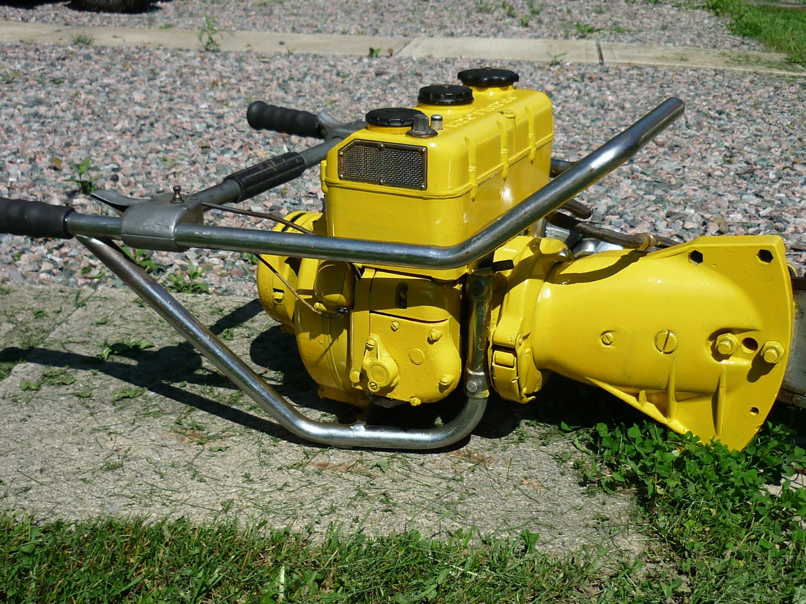

    My very first exposure to chain saws was similar to @duane. Big honking thing, in the early 50s. (IIRC it was a B&S 4 stroke vertical shaft engine, could well be wrong about that I was barely able to hold up my end.) I got to hold the handle on the bar end to start the cut, then haul ass while Pop felled a tree in the back yard. It was one of those beasts that had to have the engine properly oriented to run, so the bar was on a swivel so it could be rotated for felling or bucking.
  11. duane
    Ghrit, I think ours was a Mall, had to loosen bolts and rotate the bar to to cut vertically, engine would only run upright and was supposed to been originally designed for an outboard motor and it scared the bejeasus out of me to hold up the light end. Logged with mules and my grand dad would never use it, he used his dad's swede made cross cut felling saw and I always volunteered to help him to get out of being involved with the gas saw and my brother and I da** near fought over who would drive the mules and skid. I liked that as the mules did all the work and looked out for me and the only heavy part was carrying the peavy to roll the log if it got hung up. Never did have a cell phone or a handheld game, what a deprived childhood I had. Worked on the farm, at the sawmill, helped log and butcher, sure OHSA and the do gooders would have a fit. The horror of it all!!!!
  12. ghrit
    I've no clue what brand it was, but this business end looks like what I remember. Might be wrong thinking it was vertical shaft, but the handle bars and blade angle clamp are the same as memory dictates.
    The "light" end looked very much like this bar end handle -
    upload_2017-8-24_11-49-35.
    The only reason that saw came home with Pop is because a tree threatened the house. Well, either that or Mom was tired of the stains that got on us from the black walnuts. Anyway, working for the power company, lots of "special" tools were borrowed if needed for home projects, but they always seemed to be returned, much to my larcenous dismay.
    More antique pix -
    antique chainsaws - Google Search:
