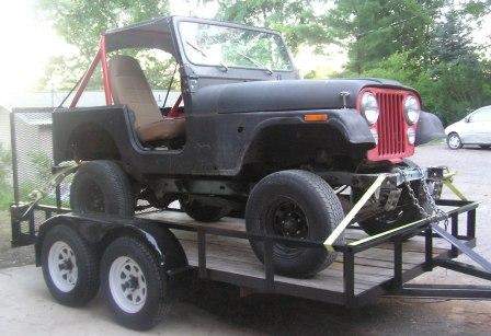

    Well I am still with my 1979 Jeep cj-7 WITH A CJ-5 BODY ON IT. Engine is a 310 (304 bored over .30 ) Converted now to run on Propane. All solid drive train manual transfer case ALL DANA. The entire frame and body were rino coated as it was a mud runner when I bought it. I changed out the engine and went through the rest of it. ITS UGLY but its pretty much all new. Very tough and has Detroit locker differentials so I get all 4 wheels when Im on the gas. It will climb almost vertical on grass with 33 inch mud terrain tires and gets about 130 miles on 10 gallons of propane. I don't however go very far with it. It has no doors or tailgate and only a bra top. I have two sets of tires, extra universals and other parts put away. Hoses, belts, water pump alternator and ignition module. I have several sets of Header gaskets and a second set of headers for it. I will have this little Jeep for many many years.

    I just posted the old picture of it when I brought it home. It doesnt look much different except for the side headers now which come out behind the front wheels. I dont have any fresh pics of it right now and anyway this is what it looks like. UGLY

    Ain't no such thang as an ugly CJ.
