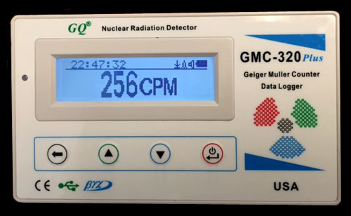

    $107 on Amazon.

    Excellent or not, it is using a Geiger-Mueller tube and thus while very accurate, it will saturate at a fairly low level. Excellent for detecting lower levels of radiation or for detecting hot spots. The Scintillation counters, often shown at places like SafeCastle and such as NukeAlert will read much higher levels of radiation, limit at 100 + roentgen rather than about 1 for a geiger. Some type of dosimeter is also needed as it shows cumulative dosage. Looks like it might be good at the price for measuring background radiation levels and for detecting either shielded or low level radiation. The one shown would alert you to high levels of radiation, but pegged, at a low level, give less help in knowing how long you have to reach shelter, gather resources, pick up the kids, etc.
    sec_monkey likes this.
  4. ghrit
    It won't tell you anything useful about your tuna unless it is hot enough to kill you by direct gamma. To assess the effects, you need to know the concentration in the meat, and what the isotope is, and what it emits. Gamma is probably not going to be significant, alpha and beta are the emissions of concern in the digestive tract.
    Now, if you want to know something about your exposure after a blast, it'll measure incident radiation at the moment it is read. (The graphing feature won't tell you a lot either unless there was a serious short term increase.) You will probably want a dosimeter to measure your accumulated dose which is what life or death is based on. Assuming you took the basic precautions to prevent ingestion of alpha and beta emitters, your risk will be entirely based on gamma.

    Mine is an RDX nuclear DX2
    uses 1 - 9 volt battery it's simple and works for every thing I need.
    I also have a sample, and the meter is right on the money.
