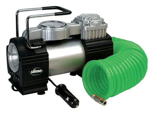

    At home, just a small pancake compressor. In the vehicles I have a small 12v compressor that claims to inflate a flat tire in 5 mins. It actually works pretty close to that. I've used that small compressor so many times I've lost count.
    This is what I have in both vehicles:
    Couldn't help you on the steel wheel, never heard of 'em.
    TheEconomist, 3M-TA3 and Yard Dart like this.

    I have a large compressor at home that can fill tires, run air tools, nail guns and the like. I need to get an onboard compressor like what @kckndrgn showed above!!

    A compressor similar to kckndrgn works well to maintain or air back up, but have never had to reset a bead with one ;)

    There is not enough volume to reset/set a bead with the compressor I have. My FIL has set a few beads with a ratchet strap and a small compressor which I might be able to do in a pinch.
