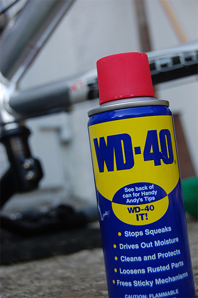

    Who knew WD-40 had so many uses.
    You may not have ever thought that WD-40[​IMG] could be used for more than loosening up rusty parts or greasing up your bike chain. In fact WD-40 can be used for many purposes that might just lead to your survival. Here are 13 ways that you can re-purpose WD-40 to help you in any situation!
    WD-40 Survival Guide | The ReadyBlog
    Also in the comment section someone wrote many other uses:
