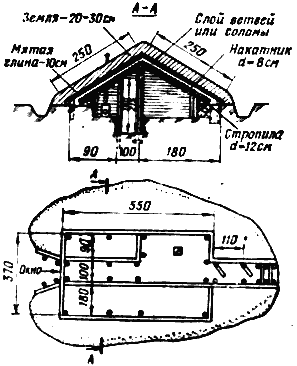

    The zemlyanka is a dwelling and auxiliary building. It is not to be constructed for cover of personnel against enemy fire. The zemlyanka is an unburied earth-wood construct and is designed for rest of the personnel in the rear, where other dwellings may be unavailable or destroyed. These may also house warehouses, headquarters, medical points, hospitals, baths, workshops, etc. etc.
    The type an capacity of the Zemlyanka are defined by its purpose. THe standard detachment zemlyanka has the following specifications:
    [​IMG]​
    - main room length 3.5m and width 3.7m
    - internal height 2.15 m.
    - labor needed - 10 man-days.
    A motorized rifle detachment, equipped with timber and entrenchment tools, can build a zemlyanka in a single day. Its habitability is guaranteed by the presence of an entrance airlock with two doors, a window, a stove, and a well-made roof. Whether it is warm or cold inside depends on your fuel, but at any rate it is better than any tent, vehicle cabin, or, of course, a tnk or IFV fighting compartment.

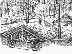

    If needed a zemlyanka can hold 200 men or even more. Oleg Tulnov has provided the author with this image of 1931 zemlyanka:
    [​IMG]​
    It is clearly visible that this zemlyanka can comfortably hold at least a platoon of troops. In such dwellings units that returned from the Great Patriotic War remained for years until the barracks and military cities ruined during the war could be rebuilt. For exampl, in the Ural Military District, the 44 Lisichansk Armored Division lived in zemlyankas from the summer of 1945 to 1954.
