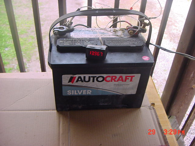

    When the SHTF supplies will limited and you will need to use whatever you can get your hands on. This an example of that. I didn't use a deep cycle battery I used an old car battery that I have been
    using for experiments for years. This battery was removed from a car when it no longer had the power to start it. I have plenty of good deep cycle batteries but I want to do like post SHTF.

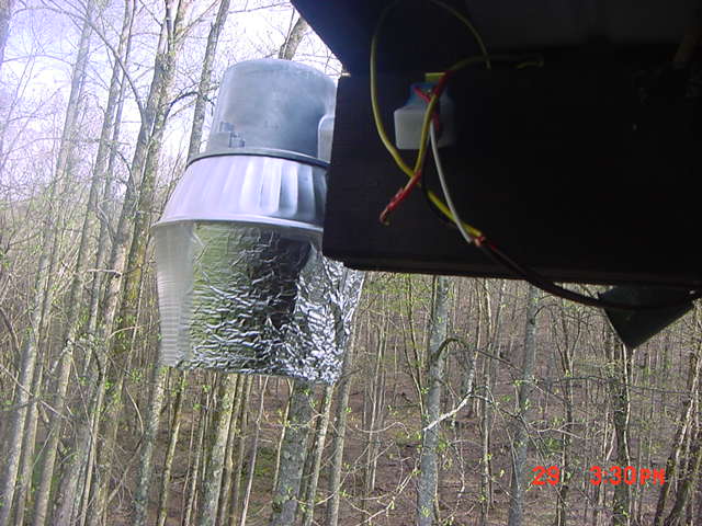

    I took a security light and switched it over to a 12 volt LED light bulb. For power I used that old car battery

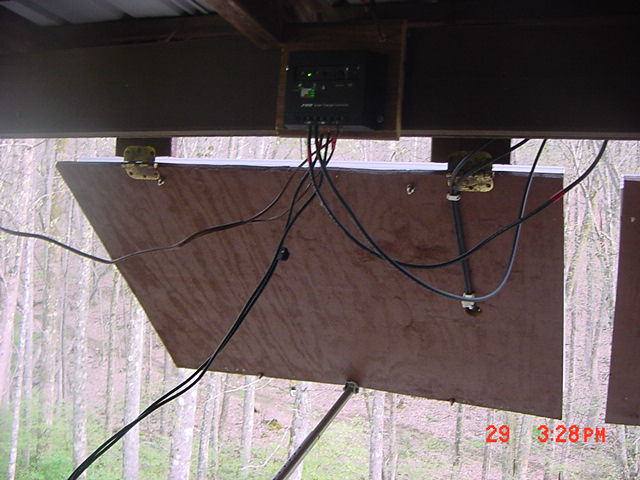

    and to charge the battery I used a 100 watt panel. I used a 12 volt photocell switch to turn it on and off.
    The battery is the same one I have been using for experments for years It sat out all winter and showed about 10 volts
    it took some charge and seems to keep up. The bulb pulls less than 1 amp
    so it doesn't take a lot of power to operate. Even this junk battery can do it.

    I put aluminum foil on the back side so it doesn't blind you at night if you are on the back porch.
    Also you can see the photocell (little white box)
    I can't believe this battery still will hold any kind of charge it's been completely drained many times in the last
    three years doing experiments. That voltage was with the panel charging it drops quick when the sun goes down
    I unhook this 100 watt panel from my system and use it for experiments when I need solar power.
    If you look close you can see the controller I use it's one of those $14 ones

    this battery drops to about 12.3 over night but I'm sure a good battery would do much better
