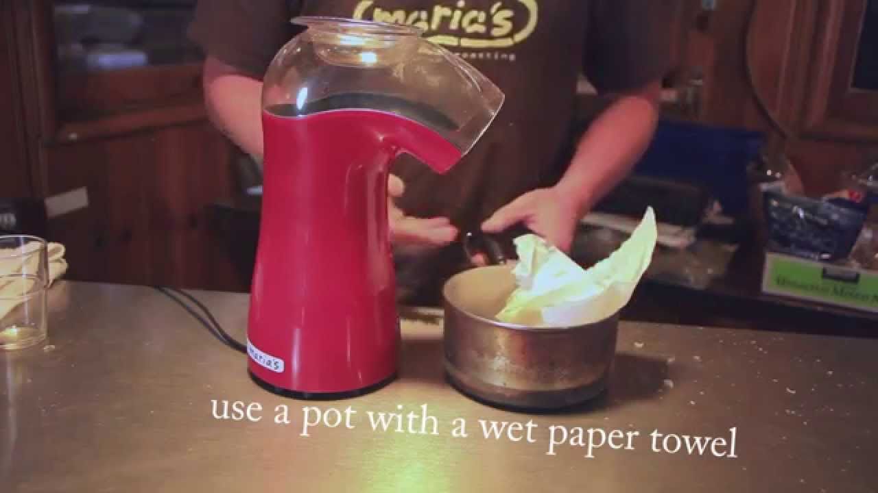

    Now to talk roasting. Let me count the ways. :rolleyes:

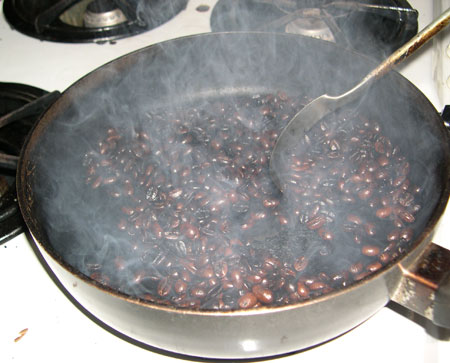

    1. On a cook stove in a cast iron frying pan outdoors is recommended. And that pan becomes a dedicated roaster.
    2. In an air popcorn popper

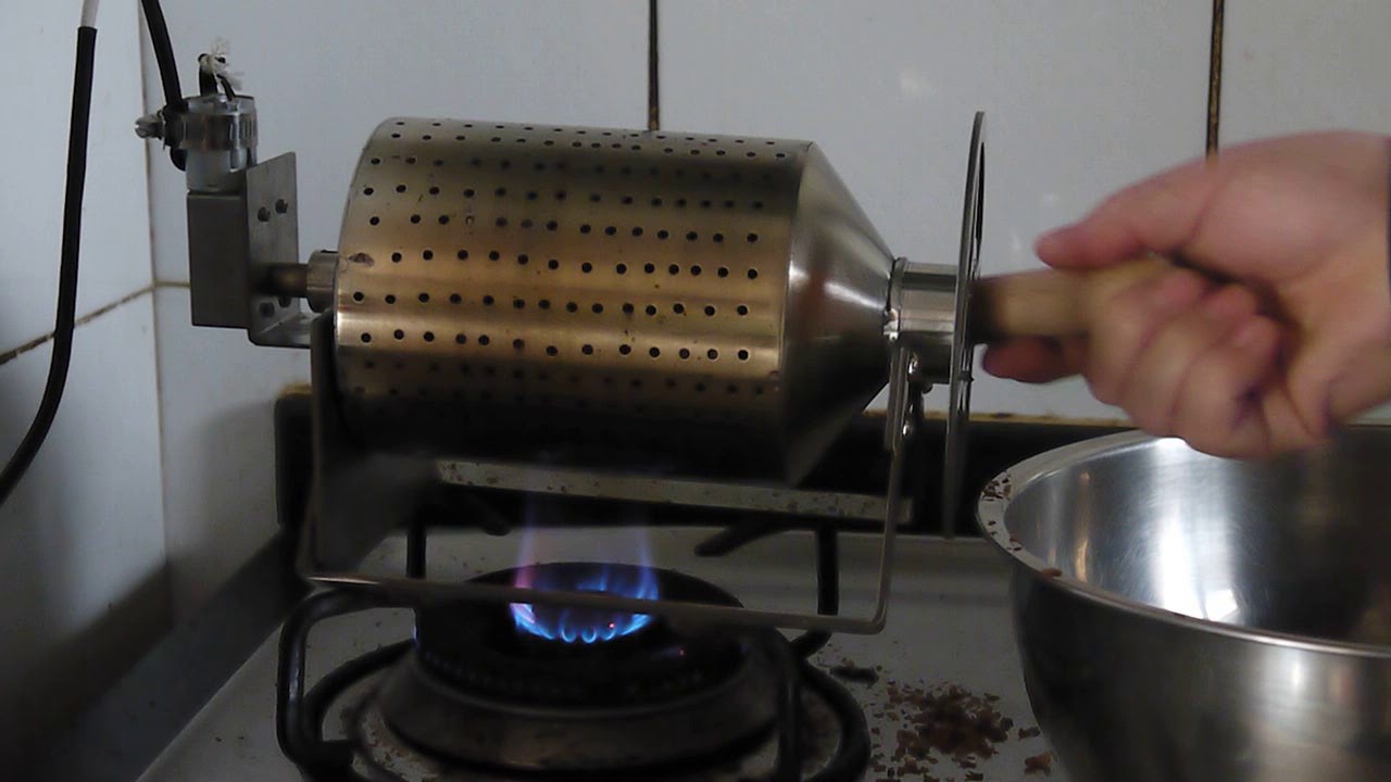

    3. In a rotating drum roaster over an open fire or propane cook stove.

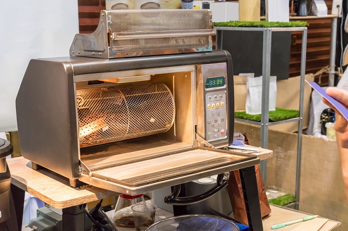

    4. In a counter top drum roaster
    5. What I roast in

    I love your pictures! I feel like I'm taking a coffee roasting workshop right now. Thank you so much for sharing your process! I wouldn't have thought of using a popcorn popper. Is that a toaster over that you use?

    [LMAO] It is a Behomr 1600 Plus roaster. The newer model is the 2000AB Plus and has a few more features. Both are dedicated coffee roasters and run on 110VAC. I recommend a dedicated 20A circuit or not running anything else on the branch circuit when roasting. My wife decided to vacuum the house one day while //i was roasting and tripped the circuit breaker ruining a batch of coffee. You don't want to interrupt a roast once you have started.

    On my roaster a 210 gram batch takes 20 minutes. Roasting in a pan is something I’ve never attempted. The head brewer at my son-in-laws brewery pan roasted cacao nibs for a stout they were brewing back in the start-up days and he tossed the cacao as you would when sautéing vegetables. There is plenty of smoke generated when roasting coffee so make sure you are up wind of that and be prepared for fire.
