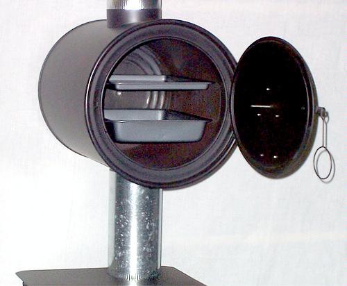

    I came across a stove pipe oven that looks like an interesting addition to a wood burner.
